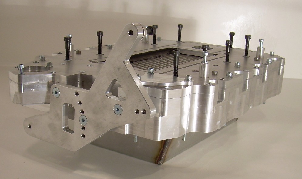

I jeszcze bardzo ciekawa opcja, jeden gość z forum z usa zaczął robić kolektor dzięki któremu można zaadoptować gt500 supercharger take off, który można kupić za 500$.
całość może wyjść 3500$.
długi temat:
http://www.allfordmustangs.com/forums/2 ... t-177.html" onclick="window.open(this.href);return false;
Mam kilka zdjęć, załączam jedno.
info jakie przychodzi na jak się zada pytanie:
Sorry there is no web site up yet, we have been slammed with getting the manifold into production.
Basic Information:
Here are some pictures of the 2nd prototype manifold that went to the first customer. The pictures are a good representation of what the manifold looks like. The production units are about 10% “cleaner” though. We have made some changes to the production units to make the fit and finish nicer. I don’t have any pictures of the production units because I have been shipping them out so fast there hasn’t been time to set up for nice shots.
The pictures that are of the manifold on the car are of the first prototype. The car it is on has a stone stock motor aside from a X-pipe and mufflers.
Here are a couple of video’s of the prototype car (the one with the wing) and the first customer with a manifold (the one on the dyno). There are 5 more customer cars with manifolds installed at this point, the Allfords forum has pics and info on them.
The first run of “Production” manifolds are being machined right now. The fisrt 20 (already sold) are done and are being shipped. Completion of the rest should be in about 7-10 days.
Retail price $1995
What is included:
The manifold kit which at this point I am calling the “GT450 Cheater Manifold” (yeah, the name doesn’t blow me out of the water but its works for now) includes the manifold itself, intercooler, alternator brackets, thermostat housing, fuel rail spacers (GT or GT500), quick change snout hub and pulley, and the fasteners required to bolt it up to the motor and the blower to the manifold (obviously the fasteners to bolt the manifold together are included). The manifold is shipped fully assembled and ready to go.
Optional items are the “Frankentensioner” kit which allows the use of two stock belt tensioners which eliminates any belt issues and there are alternate size pulleys if you want to run something other than 11-12psi of boost.
The manifold has a 1 year warranty that covers manufacturing defects.
The manifold is a “Off Road Use Only” item. Most superchargers are the same way. Very few have their 50 State CARB exemption. If you live in a state with draconian emissions laws you may want to check and see if putting a supercharger on your car is an issue. Most people find ways around it though. The "Off Road" status of the manifold/supercharger is no different than having headers, cams, removing your cats, some cold air intakes, most tunes, almost all "power adders", etc. We have to declare it as "Off Road" use only for liability reasons.

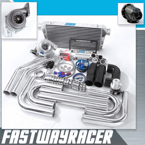

Pojawiły się nie drogie turbo kity, tzw tuner kit, sporo brakuje, ale jako starter i wyzwanie dla dobrego mechanika wydaje się nie za drogo:
http://www.ebay.com/itm/Universal-GT35- ... a&vxp=myra" onclick="window.open(this.href);return false;
Trzeba poczytać co turbiny z tej firmy są warte.

za 800$ turbokit ?? i do V6 2011 tez? to byloby idealne auto wtedy,do 5-6psi spalanie sie nei zwiekszy a do codziennej jazdy mocy az nadto ,no i ten moment :)
jesliby nawet doszlo 70HP i 120NM to za takie grosze nic mi wiecej do szczescia nie potrzeba, auto szybsze od 5x drozszego porsche,z rewelacyjna aut skrzynia i silnikiem ,do tego palace mneij niz BMW 2.0 (mialem to wiem co pisze) :)

Na pewno trzeba wtryski, do 500 koni moze na fabrycznej pompie da rady, trochę różnych kolanek, przeróbka wydechu, nazbiera się, ale i tak tanio.

caniggia pisze:Na pewno trzeba wtryski, do 500 koni moze na fabrycznej pompie da rady, trochę różnych kolanek, przeróbka wydechu, nazbiera się, ale i tak tanio.
a to fabryczne wtryski nie wyrobai do 5psi ?? w sumie nie sa takie drogie, BAP KB tez drogi nie jest, ale w 2011 chyba juz jest powrot paliwa? czy dalej pompa jest regulwoana napieciem ?
to wszystko co jest na obrazku jest w tym kicie za 800$ ??

To czy do d czy nie, to przy takim zestawie zależy jak Ci to ktoś zamontuje. to jest półfabrykat. Może się okazać, że blowoff się rozpadnie, to trzeba wymienić itp.
Turbina swoje ciśnienie pewnie nabije, pytanie jak długo pochodzi. Jak padnie, to zawsze można założyć garetta, bo mocowania te same itp.
Tanie nie znaczy złe, drogie nie znaczy dobre.
